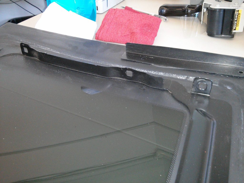

TBH, it looks like it's just glued in there some how. I took a picture to show you what I mean. You might want to talk to a body shop about getting it glued onto the framing that's bolted in.

TBH, it looks like it's just glued in there some how. I took a picture to show you what I mean. You might want to talk to a bodyshop about getting it glued onto the framing that's bolted in.
Thanks for the pictures noob2mod. I'm actually hoping that I can buy the glass with the frame attached and then bolt that onto the rails. That's kind of what it looks like from pictures of auctions like this one:

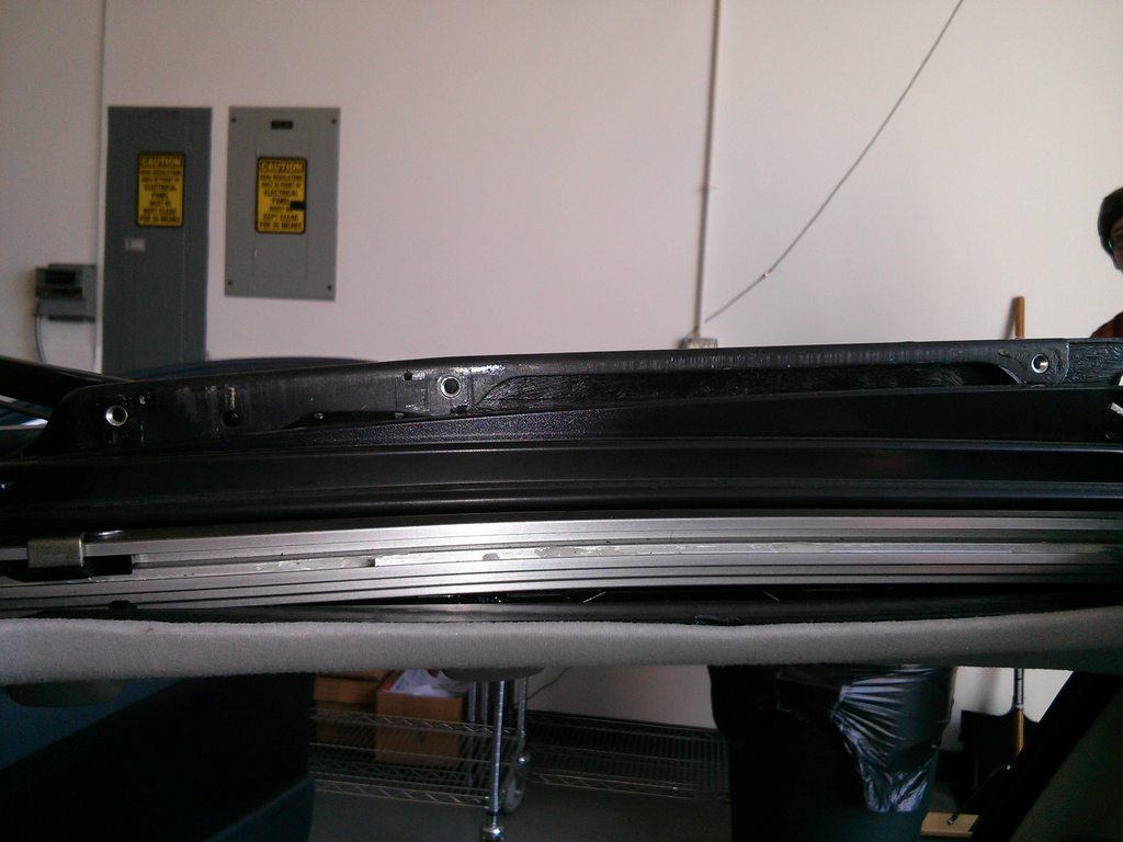

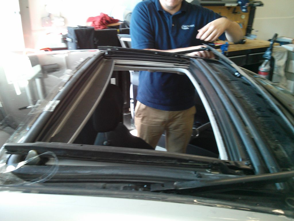

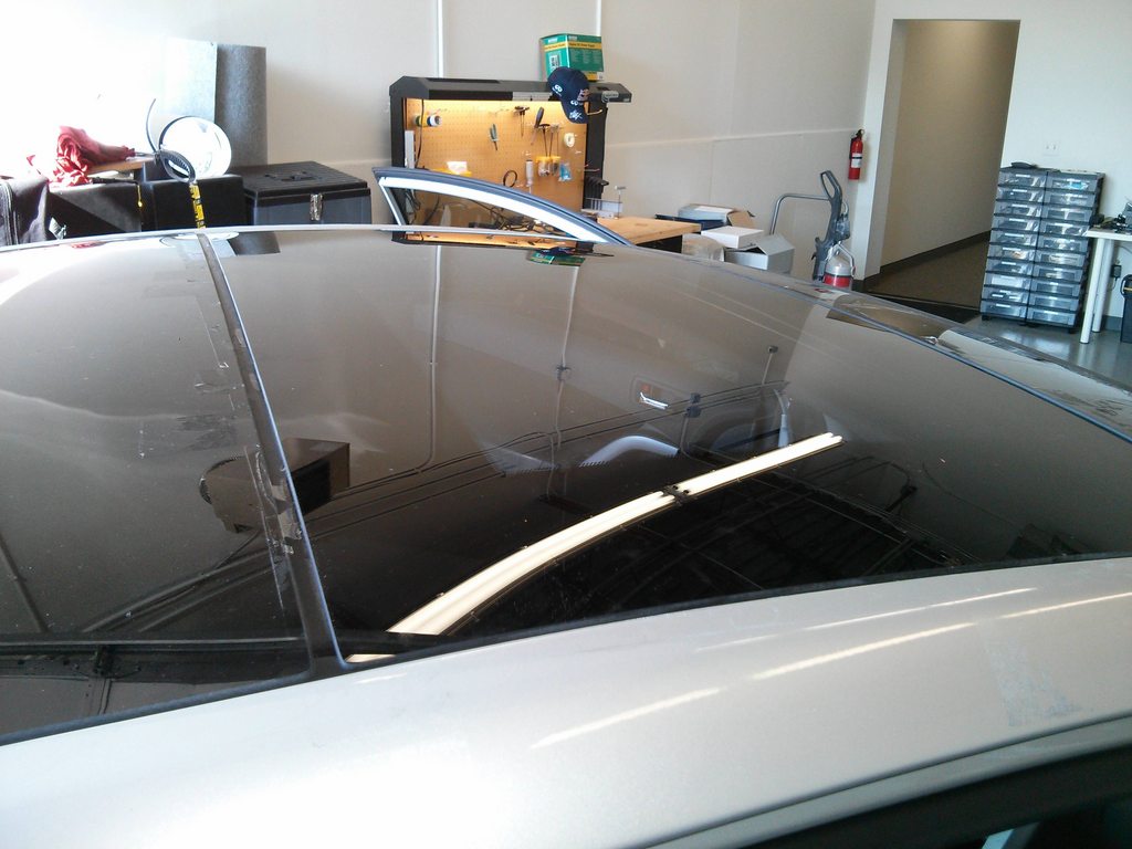

So for a little bit of resolution to this thread (and in case anyone is in this predicament and wants guidance) I ended up ordering a replacement sunroof off of Ebay for $120 shipped and replaced it myself. It was ridiculously simple as all I had to do was remove 6 torx T25 screws, lift the old sunroof out, place the new sunroof in the spot, and then replace the screws. The repair took under a half an hour.
