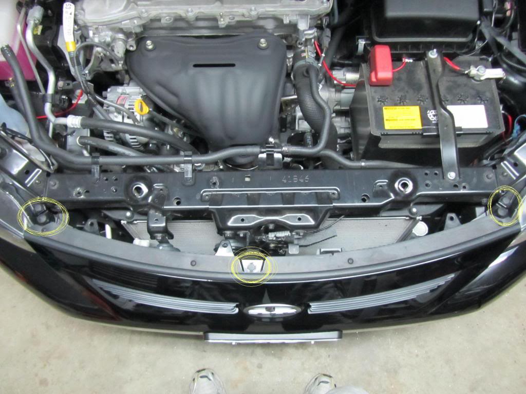

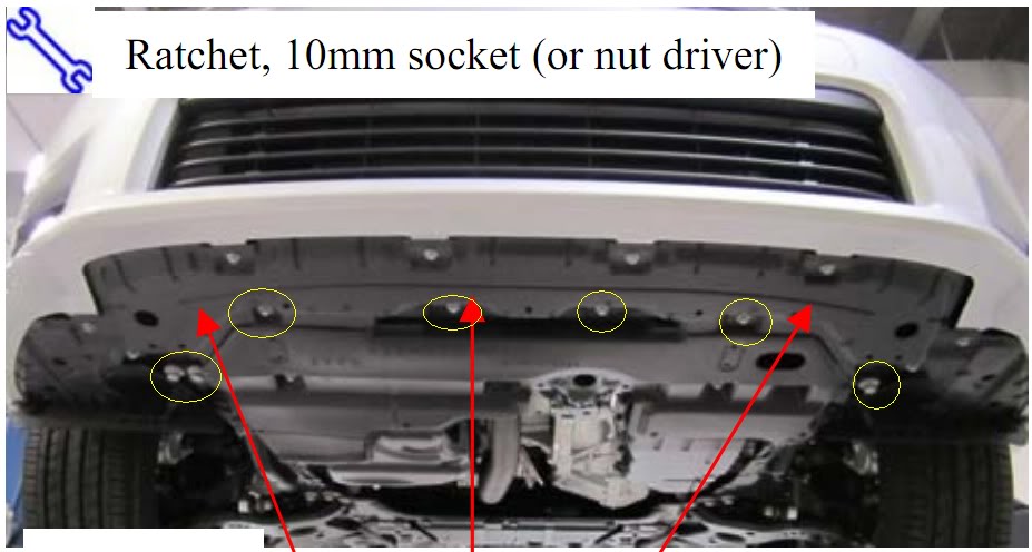

Sorry Guys I havent had time to take off the bumper so here is a little picture explanation:
Step 1:
Jack up the car in the front only
Step 2:
Remove 6 bolts that are circled in yellow(ignore the red arrows and circles)
Middle 4 bolts are definite, the side ones I'm not 100% sure
CORRECTIONSThe top right(smaller bolt) inside the yellow circle is the one that needs to be removed

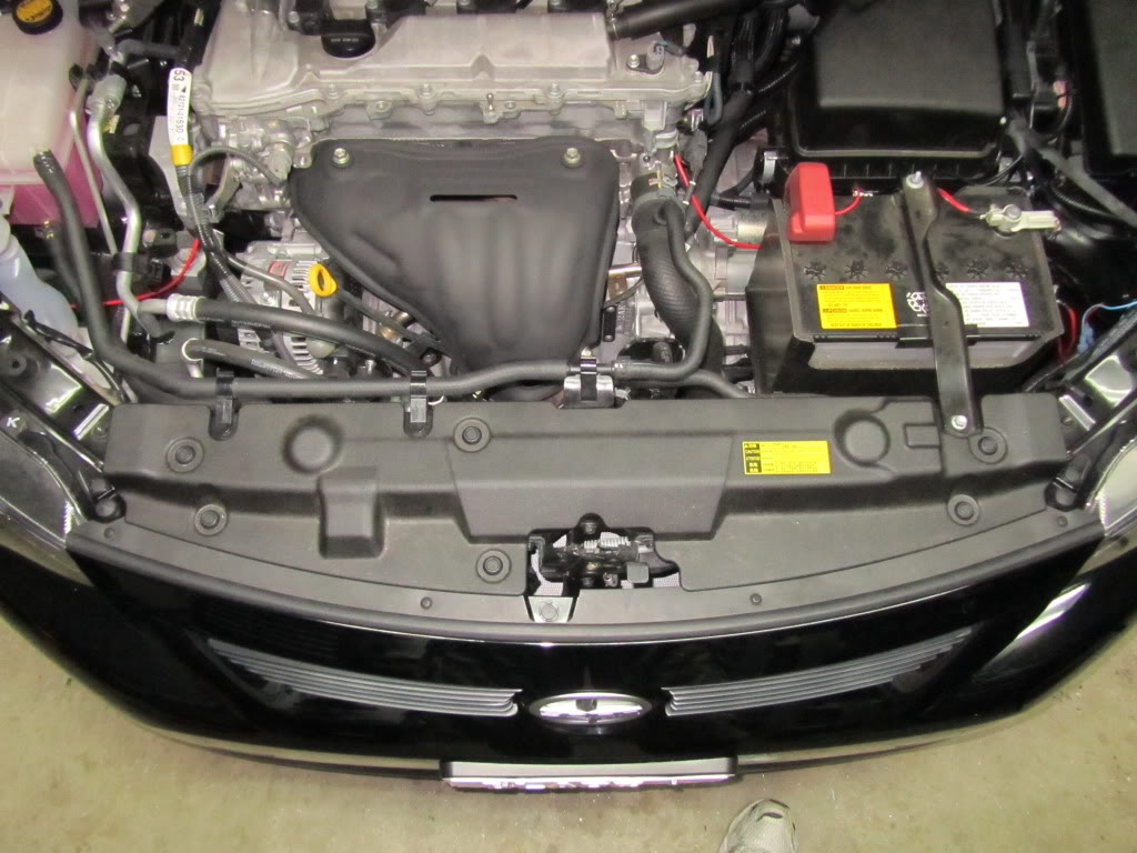

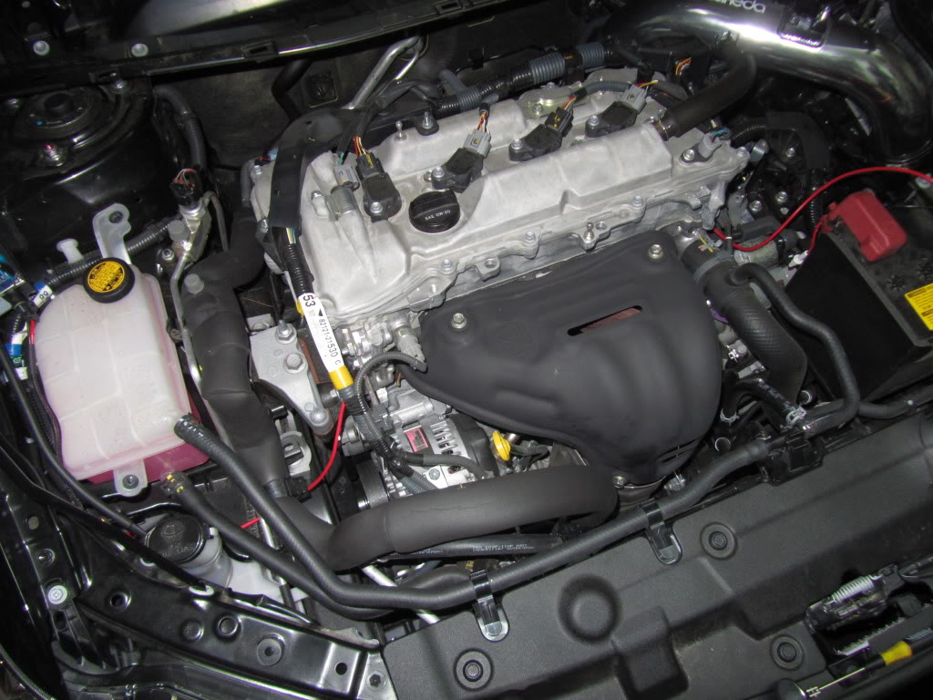

Step 3:
Under the hood remove the plastic cooling plate that's held in place by 6 plastic push-in bolts/clips
Step 4:
Remove 5 more plastic clips/bolts
Step 5:
Remove a screw and a clip from each fender
Step 6:
NOW PULL! Pull from the fender side. The bumper is only held in place by the clips that run from the fender to the headlights and right under the headlights. Repeat from the other side and it's off!
I will make a video once i have time

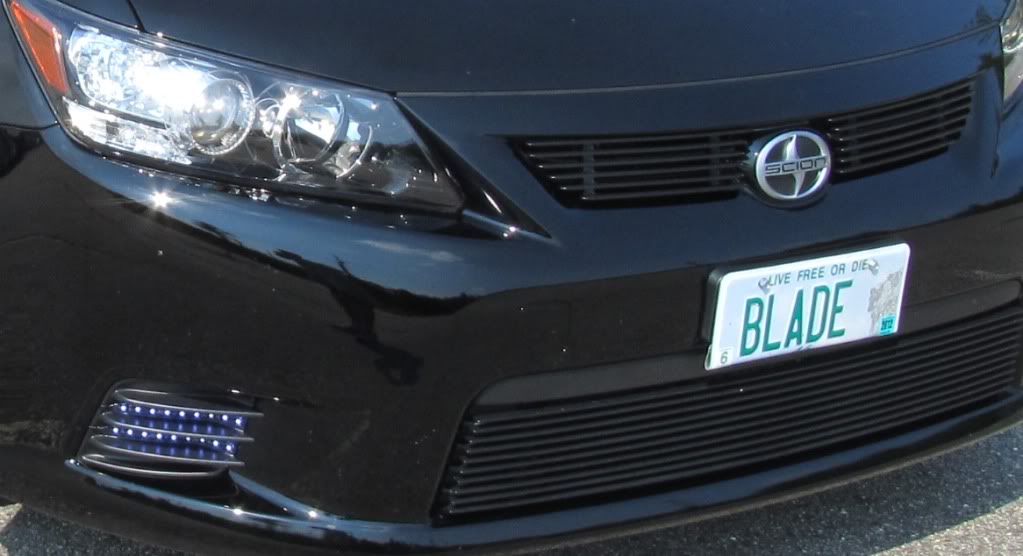

Originally Posted by CrispyFShacker
So did you cut your front license plate???
bent 180 degrees

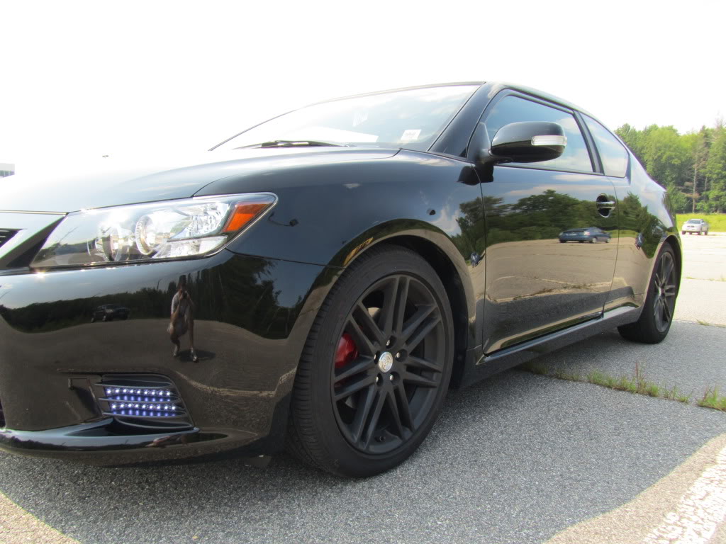

Originally Posted by Backinblacktc2
How do you like that takeda cai? notice and difference when accelerating? How's the throttle response? Sound?
Take my word buy the descendant exhaust the quality of the exhaust is amazing I'm glad I waited and purchased this exhaust the sound is amazing it's loud when it needs to be and quiet when I want I love it. With my exhaust and cai the throttle response us amazing Much better than stock.
I'll review it tomorrow after the ECU learns more. The performance seems to be gradually increasing...
takeda looks really cool...does it only come polished? i remember seeing prototypes that were a gold/bronze
also did u paint ur rims? is that like the lighting/flash that makes them look grey?
Plasti Dipped which is matte black so may appear gray. In the pic they are dirty and I've accidently spayed them with super high pressure hot stream a couple times when I was washing my car. and the flash is MAD bright! In person the wheels are sexy
you see:

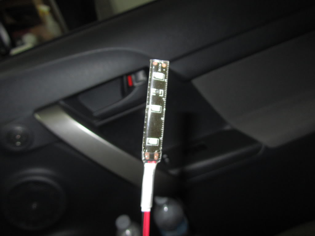

Cup Holder and Puddle Lights Locations
Link to the lights:
http://www.superbrightleds.com/cgi-b...FLS.htm#photos
I buy the ones with black circuit.
For each Cup Holder I used 3 LEDs
For each Puddle light I used 30 LEDs - standard length
Puddle Lights:
1. Stick it under the door right up against the rubber insulator
2. Drill a hole "under/behind" the 6x9 speaker because that's where the rubber boot is that leads onto the car. Drilling isnt necessary, you could feed the wire between where the plastic door panel and the metal is.
3. Lead the wire through the boot inside of the car
4. Locate the Door Switch wire and tap into it.
Cup Holder Lights:
1. Cut off the 3 LED strip
2. Solder on the wires from the Ethernet cable onto it
3. Drill a small hole in the cup holder
4. Feed the wire behind the door panel
5. Tap into the Puddle lights(parallel)
6. Stick the strip

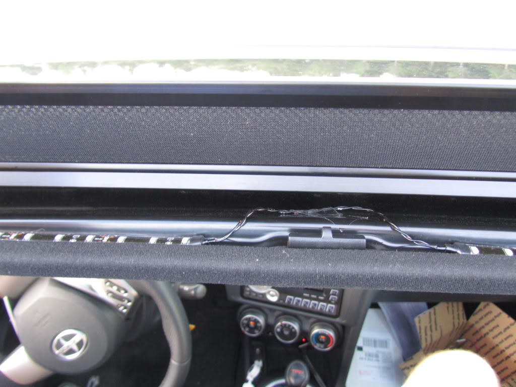

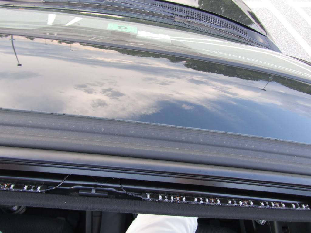

SunRoof Lights Explanation
Here is the link to the lights:
WFLS-B30
Step1: Cut the strip in the middle
Step2: Solder them back together using ~5-6 inches of ethernet cable wires
Step3: Shrink wrap and paint black
Step4: Stick the strips inside of the little "ditch" at the front end of the sun roof
Step5: Run the wires through the headliner down to fuse box
Step6: Connect through a switch to a constant 12V source

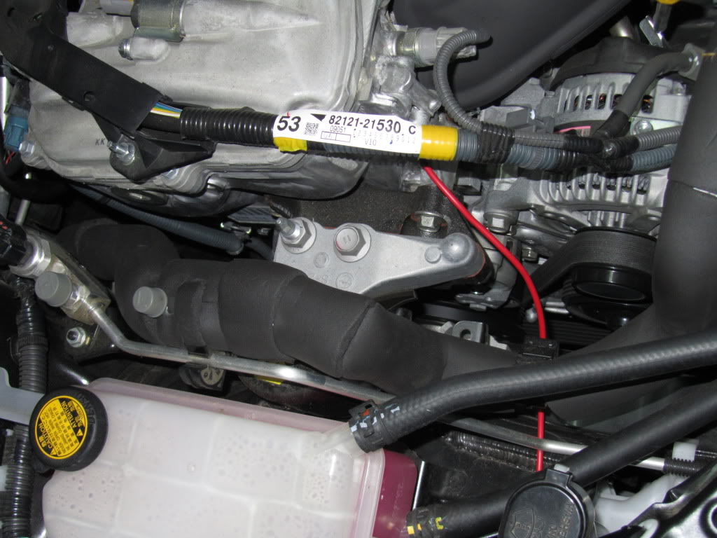

AC Line Insulation
b4
now

Yuriy, how'd the black insulation next to the exhaust look after your trip home? Let me know how it is after your trip to work tomorrow! Hopefully it won't need the ugly aluminum tape too.
