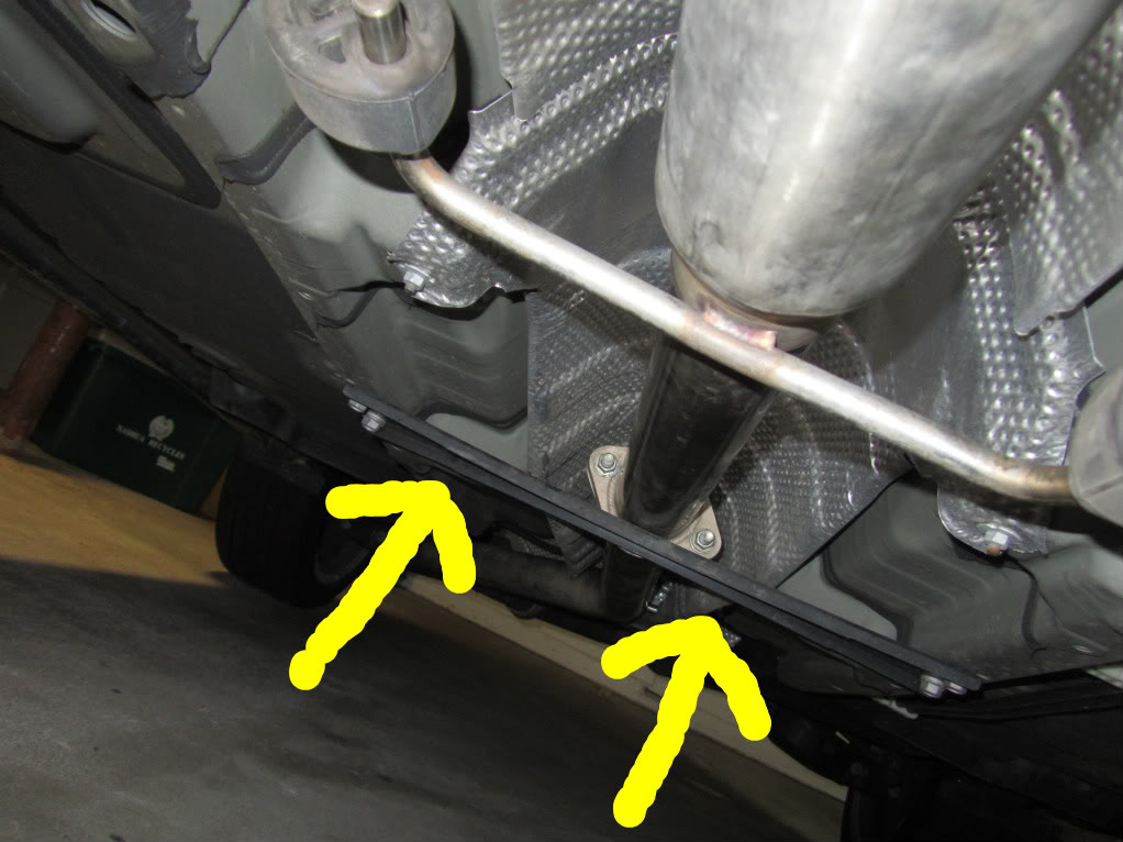

Here are some under car pics
So on stock hangers the exhaust immediately started rattling against this metal bracket:
so i used some leftover AC insulation wrapped into foil
well it only lasted 1 day
So as a result I took the bracket off completely

Whoa...isn't that supposed to be for chassis rigidity? Looks like someone is probably going to be getting some TS hangers...
Old 09-27-2011 | 06:35 AM
  #588
Scion202's Avatar
Joined: Mar 2011
Posts: 2,102
From: Nashua, NH
yeah most likely however it's not located in the most crucial place so it's not that big of a deal. center of the car experiences very little force since it's the center of rotation...blah blah haha
Old 09-27-2011 | 06:36 AM
  #589
Scion202's Avatar
Joined: Mar 2011
Posts: 2,102
From: Nashua, NH
however it also could have been there to just prevent exhaust from falling off in the future when the hangers fall apart
Old 09-27-2011 | 06:38 AM
  #590
biglilsteve's Avatar
Joined: Nov 2010
Posts: 2,745
From: Maryland
Let's just call it weight reduction.

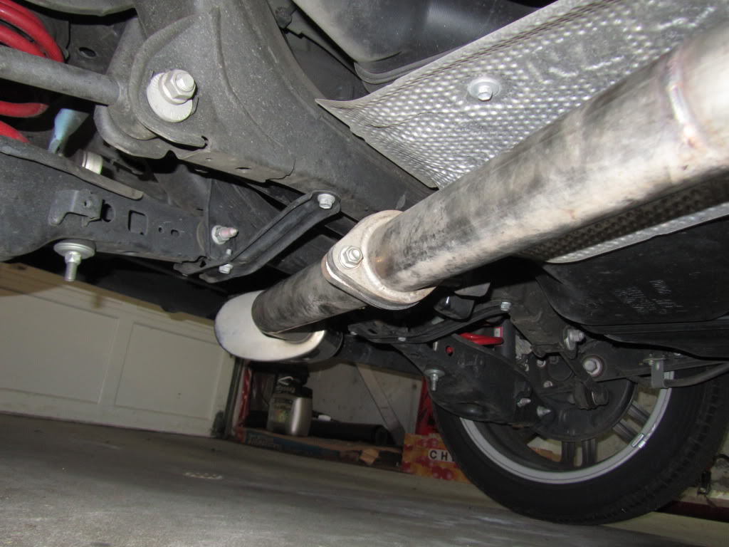

here is a better view haha

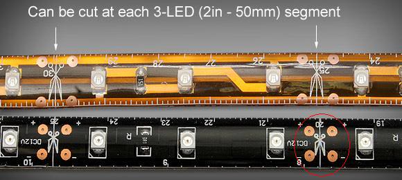

Default LED strips
Originally Posted by JimmyTC
hey man still interested in trying to do the speaker lights.. need some help.
for just the speakers.. did you buy a 60 led strip of wlfs and a 30 swlfs? also how would you cut the leds and reattach them? for example we would cut the swfls into two for each side.. but the wire would only be attached to one? please help in anyway possible. thanks!
I bought this model: WFLS-B60
I believe I bought 3 60LED weather proof black strips
I figured it out by measuring diameters of the speaker grilles and then found the exact circumference by a formula
Circumference = 2 x PI x Radius where radius is half diameter of course
the strips are 40 inches long which is roughly a 1 meter
Yes you have to cut them and then solder. Its very small and tediuos job but I have a microscope at work and soldering under it is a breeze!
If anyone needs help with soldering, I could do it for you for a couple bucks or even free. Obvi you have to pay shipping
I find soldering relaxing lol
here is a pic of the LED up close, you can only cut where you see scissors and then you have to solder onto those 2 little copper lead
