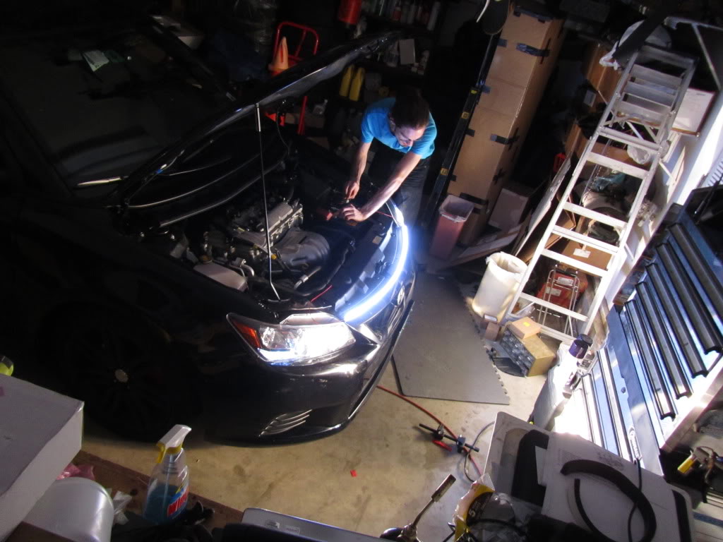

Front Grille Lights DIY#1
Price: $12
Included: Control Box, 48LED blue strip, wireless remote
Here is the ebay link to the LED strip:
http://cgi.ebay.com/48-LED-Blue-Car-...#ht_5636wt_906
I bought 2 of these then unplugged the LED strip from the control box and plugged it into the other one because each box has 2 slots to control 2 LED strips.
Initially I mounted the strips on the inside of the bottom part of the top grille pointing diagonally down(45 degrees).
Recently I had the bumper off and decided to remount them so here is what I did:
1. Using Industrial Velcro I mounted the control box to the air box

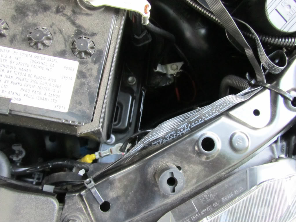

2. Connected the power leads to the battery, WHICH IS REALLY REALLY BAD but at least I used a fuse
This will eventually be routed into the car and hooked up to a switch
3. Zip tied the LED wires to the chassis
4. Ready to mount

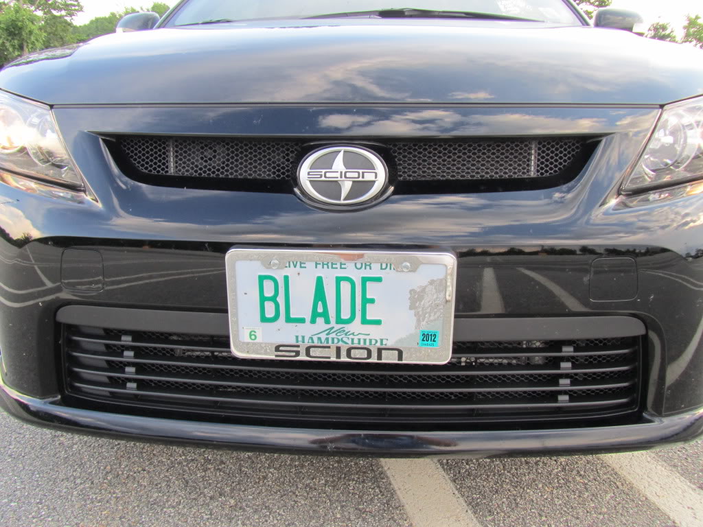

5. Using double sided tape, stick one LED strip at the top of the metal bumper facing the radiator
6. Repeat step 5 but stick the LED strip to the bottom of the metal bumper and zip tie all around it.
YOU' RE DONE:
FINAL:

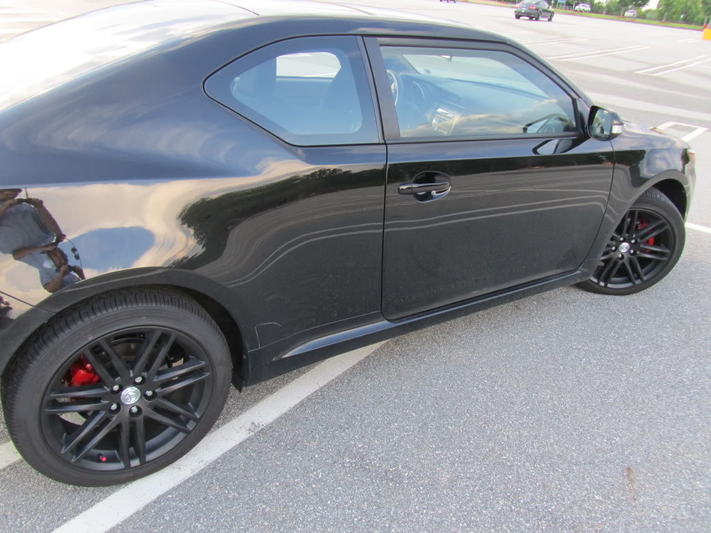

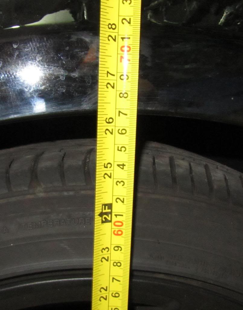

SO:
REAR: 2.4 cm drop
Front: 2.1 cm drop

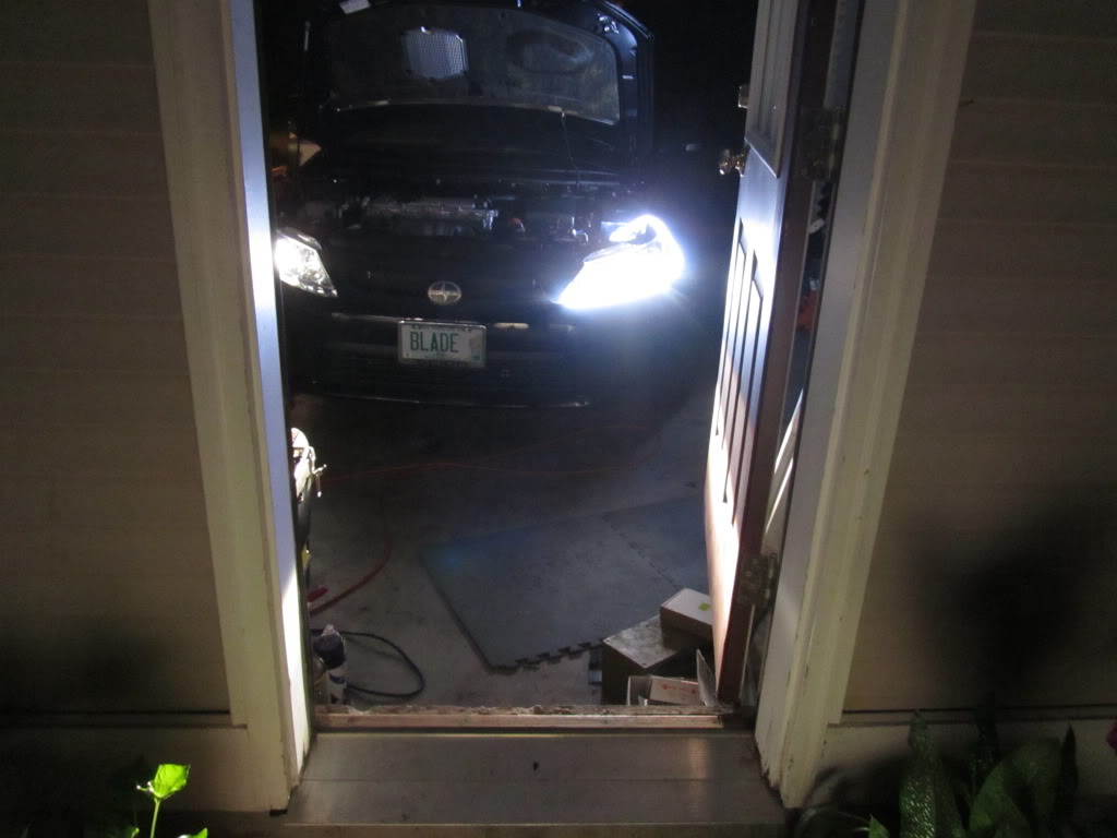

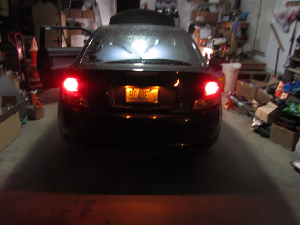

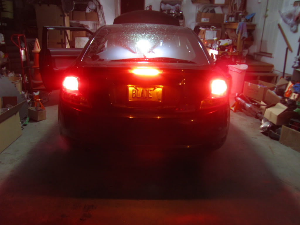

From: Nashua, NH
68 LED Break Light Bulb:
It took my friend and I 2 hours to get this to work. Apparently all the diagrams for the CK and regular type dual filament LEDs are wrong. The tail light is swapped with the break light. Maybe I'll try to make a how-to on this in a bit.

LED on left....stock is so SLOW!
