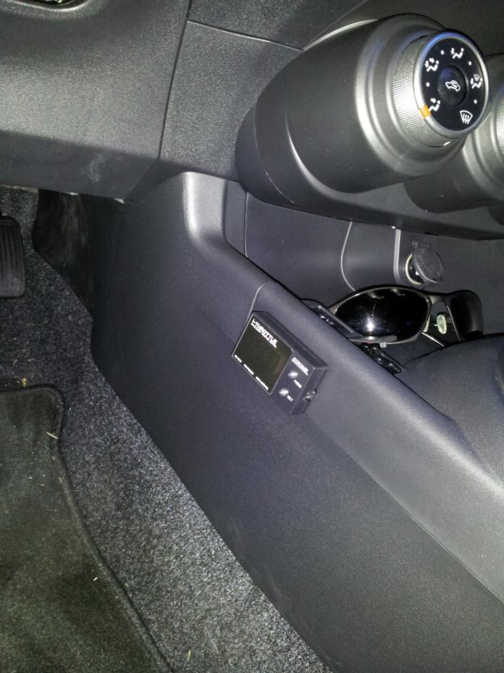

What stupid thing did I do now that my brand new car wont even crank
I was toying with my Weapon R Throttle Controller (which I had a blast with, I just installed it today) then when I came home and tried to start it again all the dash lights would come on and my Ultra-Gauge (Which I love) gave me a engine code of P2138 which has to do with the Accelerator Pedal Position (APP) Sensor.
I then disconnected the Weapon R Controller and made sure every cable was attached nicely. I even checked some fuses. I been messing with the car and Googleing for hours and I have no go answer. Usually when this happens to other folks the car will drive, just poorly.
NOTE: When my key is in the IGN position I can hear the throttle plate move just fine as I press the pedal so I know my pedal is working.
So over-night i'm going to leave all the cables unplugged and dis-connect the battery (again). Or is there a better way to reboot the ECU?

I found the problem...
Ok well I'm still blaming this on my Weapon R Throttle Controller.
I checked every fuse under the hood and under the Dash. A stupid little 5A fuse was blown. Its called AM1 what ever that means. Its an ignition fuse. I would have checked it last night what I didnt think a 5A fuse that says AM1 would keep my car from starting. How about calling it IGN or something smart.
The car is running fine with no engine light. I can hear my baby Idling in the garage from here..
I'm so glad I didnt call the dealer. I told myself to check every cable and fuse first, glad I did.
