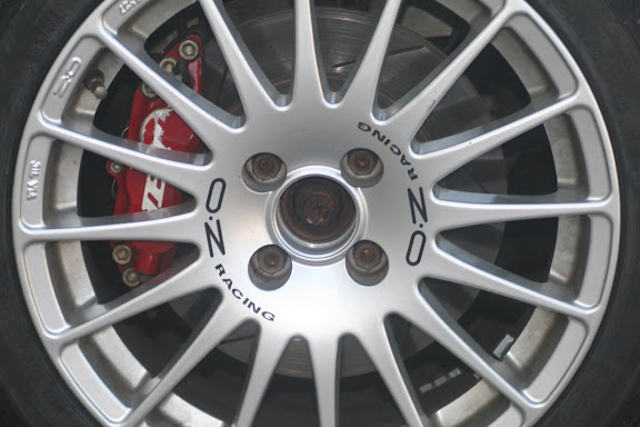

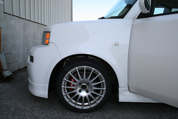

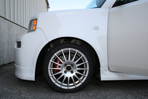

i'm running 16" wheels now, my 15" panasports will need longer wheel studs and a spacer (just 5mm) to clear. ironically i just found this out 30 min ago putting the car in the air to toss the 15" panasports back on, i'm on the phone pricing longers studs now.
i can take pics with the 16" on as of now though, sometime next week i can with the 15"s
ok pics with the 16"s as i'm waiting for hardware to slap the 15's back on
the rubbing/paint lose on the caliper is not from the 15"s either, they are from the previous owner, no rubbing issues here (and once my hardware comes it to space my 15"s out there won't be any rubbing issues with those either)
