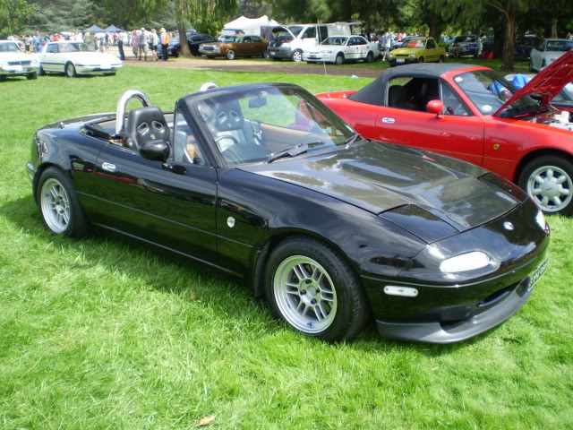

^ The 195/60-15 tires are going to look more balloon like. Those need to be on a 7.5" to 8" wheel to get them to look less balloon like. That or you can run wider 205/55-15 tires. Same diameter as 185/60-15, but more wider.
These are not a Scions, but this is what 195/60-14 looks like on a 14x7 wheel. It's going to look the same on the Scion, but being 1" larger.
![](http://farm5.static.flickr.com/4047/4492136676_cf0d9bb6cd_b.jpg)
![](http://i640.photobucket.com/albums/uu128/97mmiata/RPF1_sideview2.jpg)
This is what 185/60-14 looks like on a 14x7 wheel.

The 185 tires on 7 look a lot better.
