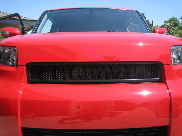

Thanks for the great idea XB BOB.

^^How in the heck did you get a picture of my grill dude? Looks good right?
